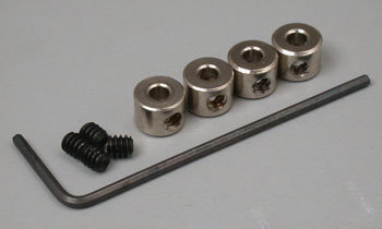

I was thinking about a way to control the depth of the drilling for your jig that would be more accurate than tape on the drill bit and came up with this:
These are as I know you know from one of our shared previous hobbies model airplane wheel collars. They come in 3/32" inch too - perfect for the 3/32" drill bit required for Stew-Mac's side dots. You can purchase these here - Tower Hobbies or at any hobby shop that carries RC products.
I would be concerned about the wheel collar marring the wood fretboard side but this would not be an issue with your metal jig/guide.

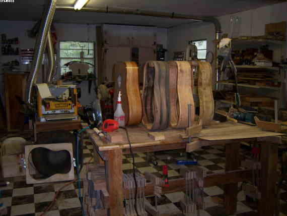

Hesh, you always seem to catch me at times when my shop is the messiest it can be.... oh well, I'll show you anyway... just dont mind all the sawdust on the floor.
First, here are a few of the guitars I am working on... from left to right,  Sycamore, Malaysian Ebony, Curly cherry, and flamed Oregon Myrtle. Also on the bench is the back to the flamed myrtle guitar that I am gluing the back strap on. On the right hand side of the picture, you can see some of my WAS stock on the shelf. On the floor next to the mold is a case of 50 Englemann spruce tops that came in recently from Canada. My bender is on a shelf by the window in the back of the shop.

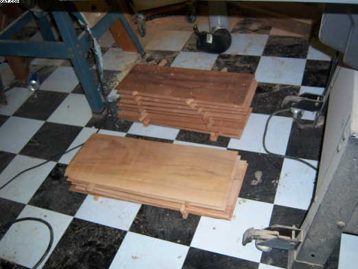

Next is a picture of some sets of wood I will be swapping out at the next swap meet... different kinds of mahogany. Some of it is quite figured stuff. I have a lot of stuff to resaw in the next couple of weeks to get ready for the swap meet come to think of it.
